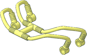

yes ...Magnus...noticed too late for some seconds...corrected
Ulrich Röder [UR]
2019-04-18 02:50:02
corrected positions to help the tubes over the valve banks....
but i'm not sure...the tubes seem to be to long...and so the bows to high...mmmmh

https://imgur.com/a/A9ymDPh Top of the bows should drop by about 13 LDU.
Ulrich Röder [UR]
2019-04-18 18:45:01
corrected height...I guess that works now..

wow..that's great...amazing pictures...thamks a lot jrathage...
I was probably right with my guess.....
very good to see now ... thanks again!

There's a small collision with the distributor here:
1 71 0 -40 -70 -0.707 0 0.707 0 1 0 -0.707 0 -0.707 32828.dat
1 0 10 -32 -20 0 0 1 0 1 0 -1 0 0 92280.dat
1 0 -10 -32 -20 0 0 1 0 1 0 -1 0 0 92280.dat
1 71 0 -38 -44 1 0 0 0 1 0 0 0 1 30191-f4.dat
1 0 0 -32 -70 1 0 0 0 1 0 0 0 1 15573.dat
1 0 0 -48 -70 1 0 0 0 1 0 0 0 1 18674.dat
Ulrich Röder [UR]
made the following comment.
2019-04-28 19:00:01
Yes, I knew about it...
Funny..isn't it?
...but that's the equal fact, if you turn it 7,5 degrees down:
1 9 10 -32 -20 0 0 1 0 1 0 -1 0 0 92280.dat
1 9 -10 -32 -20 0 0 1 0 1 0 -1 0 0 92280.dat
1 9 0 -32 -70 1 0 0 0 1 0 0 0 1 15573.dat
1 9 0 -48 -70 1 0 0 0 1 0 0 0 1 18674.dat
0 // Inlined: 1 71 0 -38 -44 1 0 0 0 1 0 0 0 1 30191-f4.dat

I think this is something, we have to deal with. I assume the collision will not happen in real life as the parts are a little bit smaller than modelled in Ldraw.

* Too much detail. Inlining it you get more than 13000 faces!

should this be done with torus/cyli prims?
Jeff Jones [notmaster]
2025-05-10 13:16:05
yup i think

* I did some test myself and now I'm fine with it.
2026-07-28 13:52:29
I think the arms should be subfiled, to be re-used.

I don't think this works. Now there is a collission on the rear cables.
1 38 70 14 44 0 0 1 0 1 0 -1 0 0 30236.dat
The 2 pairs, front and rear, are different.
.. but there's allready an even bigger collission, as stated above. Well, well...

Better?
Willy Tschager [Holly-Wood]
2026-08-06 14:25:04
* Regenerated tube to avoid collision

Assuming this is the full motor assembly, then there's a collision with the 2x2 round plate in the front (can the center piece even be placed parallel to the plate?):
1 16 0 -46 -4 1 0 0 0 1 0 0 0 1 30191-f1.dat
1 0 -40 -8 -20 0 0 -1 0 1 0 1 0 0 3035.dat
1 0 40 -8 -20 0 0 -1 0 1 0 1 0 0 3035.dat
1 0 10 -40 20 0 0 1 0 1 0 -1 0 0 92280.dat
1 0 -10 -40 20 0 0 1 0 1 0 -1 0 0 92280.dat
1 0 0 -64 -30.001 1 0 0 0 1 0 0 0 1 4740.dat
1 0 0 -56 -30.001 1 0 0 0 1 0 0 0 1 18674.dat
1 0 0 -40 -30 1 0 0 0 1 0 0 0 1 15573.dat
1 0 -70 -32 0 0 0 -1 0 1 0 1 0 0 3039.dat
1 0 -70 -32 40 0 0 -1 0 1 0 1 0 0 30236.dat
1 0 70 -32 40 0 0 1 0 1 0 -1 0 0 30236.dat
1 1 0 -56 90 -1 0 0 0 1 0 0 0 -1 76766.dat
1 1 0 -64 40 1 0 0 0 1 0 0 0 1 60474.dat
1 1 0 -32 20 0 0 -1 0 1 0 1 0 0 3001.dat
1 1 -10 -72 50 -1 0 0 0 1 0 0 0 -1 27925.dat
1 1 10 -72 50 0 0 -1 0 1 0 1 0 0 27925.dat
1 1 -10 -72 30 0 0 1 0 1 0 -1 0 0 27925.dat
1 1 30 -72 30 1 0 0 0 1 0 0 0 1 27925pb005.dat
1 1 -43 -44.516 0 0 0.5 -0.866 0 0.866 0.5 1 0 0 3069b.dat
1 1 10 -48 39.999 0 0 -1 0 1 0 1 0 0 32028.dat
1 1 -10 -48 40 0 0 1 0 1 0 -1 0 0 32028.dat
1 1 43 -44.517 59.999 0 -0.5 -0.866 0 0.866 -0.5 1 0 0 2431.dat
1 1 -43 -44.517 60 0 0.5 -0.866 0 0.866 0.5 1 0 0 2431.dat
1 1 -39 -37.588 40 0 0.5 -0.866 0 0.866 0.5 1 0 0 3666.dat
1 1 30 -32 40 0 0 -1 0 1 0 1 0 0 3937.dat
1 1 30 -32 0 0 0 -1 0 1 0 1 0 0 3937.dat
1 1 -30 -32 40 0 0 1 0 1 0 -1 0 0 3937.dat
1 1 -30 -32 0 0 0 1 0 1 0 -1 0 0 3937.dat
1 71 0 -48 -30.001 0 0 1 0 1 0 -1 0 0 32828.dat
1 71 -35 -30.66 0 0 0.5 -0.866 0 0.866 0.5 1 0 0 3938.dat
1 71 35 -30.66 39.999 0 -0.5 -0.866 0 0.866 -0.5 1 0 0 3938.dat
1 71 35 -30.66 0 0 -0.5 -0.866 0 0.866 -0.5 1 0 0 3938.dat
1 71 -35 -30.66 40 0 0.5 -0.866 0 0.866 0.5 1 0 0 3938.dat
1 72 0 -40 50 1 0 0 0 1 0 0 0 1 3023b.dat
1 72 0 -56 30 1 0 0 0 1 0 0 0 1 3023b.dat
1 72 0 -32 -30 1 0 0 0 1 0 0 0 1 3700.dat
1 272 -70 -40 40 0 0 -1 0 1 0 1 0 0 3666.dat
Also should this get a !HELP line for placement?

Your code is wrong. You cannot push down the Plate 2x2 Round this far, as it will also collide with 32828.
1 0 0 -58 -30.001 1 0 0 0 1 0 0 0 1 18674.dat
1 0 0 -66 -30.001 1 0 0 0 1 0 0 0 1 4740.dat
2026-10-14 19:56:46
Yes, I was too lazy to turn that 32828 in the correct position. If done like shown in the instruction, the Plate 2x2 Round can correctly connect to the stud below (with the bar from 32828 fitting in the plate's notch):
1 71 0 -48 -30 -.7071 0 .7071 0 1 0 -.7071 0 -.7071 32828.dat
So there should only be the collision with the hose.
Flexible sub-parts are placed in Parts folder. The s\ is not needed.
And the parts are called 30191k01-30191k03.
