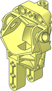

Constraction Torso  5 x  7 x  4 with  2 Angled Pin Holes
0 Constraction Torso 5 x 7 x 4 with 2 Angled Pin Holes 0 Name: 47305.dat 0 Author: Max Murtazin [SwampKryakwa] 0 !LDRAW_ORG Part UPDATE 2025-04 0 !LICENSE Licensed under CC BY 4.0 : see CAreadme.txt 0 !HELP The angle of the connholes is 22.4846 degree. 0 !HELP The position of pins would be: 0 !HELP 1 16 46.227 -19.1684 0 .918 .396 0 -.3963 .918 0 0 0 1 3673.dat 0 !HELP 1 16 -46.227 -19.1684 0 -.918 -.396 0 -.3963 .918 0 0 0 1 3673.dat 0 BFC CERTIFY CCW 0 !KEYWORDS bionicle, block, connector, Toa Hagah, Toa Metru 0 !HISTORY 2022-03-24 [Lehvak_Nuva] Original part geometry 0 !HISTORY 2022-03-24 [SwampKryakwa] Part preparation for the part tracker 0 !HISTORY 2022-12-13 [Holly-Wood] Subfiled, closed gaps, added edges and conds, more prims, sanded geometry 0 !HISTORY 2025-04-27 [OrionP] Official Update 2025-04

Max Martin Richter [MMR1988]
posted a vote of Hold.
2022-04-20 20:05:01
Misses several edges and condlines.
Some faces around the connholes bleed through the other surfaces.
Part could be splitted and one half could moved to a "half" subpart which is used mirrored in this file.

Willy Tschager [Holly-Wood]
2022-12-13 18:45:02
Existing certification-votes were deleted.
2023-05-25 18:52:30
Missing correct History.
2023-05-27 07:38:28
Fixed HISTORY
Part Reviewer
made the following comment.
2023-05-31 14:31:23
Would be better moved to Constraction category, I think
2023-12-27 22:12:20
This cyli is too long and produces a bleed in.
1 16 0 -20 40 9 0 0 0 0 9 0 -20 0 4-4cyli.dat
Misses two edges:
2 24 2.096 -28.583 22 2.096 -28.583 40
2 24 -2.096 -28.583 40 -2.096 -28.583 22
2023-12-30 13:49:24
Added edges. Fixed prim.
posted a vote of Certify.
2023-12-31 13:03:11
edited the part header.
2023-12-31 13:51:31
Header Edits
keywords:
to
Technic, Connector, Block, Bionicle, Toa Metru, Toa Hagah
description:
Technic Connector Block 4 x 5 x 6 with Angled Two Pin Holes
to
2023-12-31 13:53:55
Header Edits
category:
Technic
to
Constraction
Rene Rechthaler [Blechtaler]
2024-01-12 20:35:39
Orion Pobursky [OrionP]
2024-01-27 14:29:48
The origin needs to move somewhere more logical
2024-02-11 17:42:36
Changed origin
2024-02-11 21:54:39
May be better to have it in the intersection point of the three pinholes.
2 12 0 0 -30 0 0 18
2 12 0 0 -30 -44.39 -18.373 -30
2 12 0 0 -30 44.39 -18.373 -30
Help info about position and angle of the pinholes?
2024-02-13 17:56:50
Changed origin, added help
2024-02-13 19:50:42
did you forget to delete the pins?
2024-02-13 19:56:41
I did
2024-02-28 19:13:07
2024-08-17 05:21:37
Header Edits
keywords:
bionicle, block, connector, Technic, Toa Hagah, Toa Metru
to
2025-04-18 14:03:45
posted a vote of Admin Review.
2025-04-21 15:30:00
2025-04-27 06:57:29
Release 2025-04
This part is copyright © Max Murtazin
LDraw.org Parts Tracker, Arsenii Babin, Willy Tschager, Orion Pobursky,
