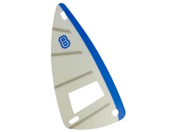

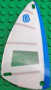

* I presume you used an image like this:
https://www.bricklink.com/TL/65598.jpg?0
for the template? Unfortunately, an unfortunate choice as this is a misprint. Most images show this version instead:
https://www.bricklink.com/PL/6351pls01.jpg?0
https://thumbs.worthpoint.com/zoom/images2/1/0710/26/lego-6351-surf-sail-camper-box_1_bba43846fc84c77ac11ddd10c7d2f11c.jpg
https://i.pinimg.com/originals/1b/00/ac/1b00acb8283f7bc2210132e0e9641d27.jpg
The configuration used in your pattern wouldn't work as the bottom batten would collide with the boom IRL.

The underside of the 8 is wider than the top at the real part and the grey stripes are smaller.
