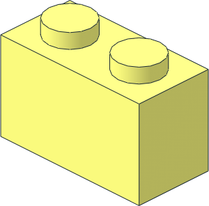

I think this part maybe never existed in real life. All non-stud logo 1x2 bricks of the slotted era had either 1 or 2 slots. The first non-slotted 1x2 bricks had stud logos (and there were also slotted bricks with logos at the same time). In other words, it should still be correct to use 3065.dat even for early 1x2 bricks without slots.
made the following comment.
2023-11-28 16:15:56
So what do you want to do?
Should this file be made obsolete, and/or is it an alias of 3065?
N. W. Perry [Plastikean]
2023-11-29 01:55:18
On further research, I think this is true of all the Mursten-era bricks: the elimination of slots seems to coincide with the introduction of logos on studs, so there will always be at least one slot on a non-stud logo part (with some random exceptions like Swedish PRIMA bricks…)
At the same time this means there is a need for hollow bottom bricks with stud logos, so perhaps we should keep the -a variants with the logos, and change only the ones with slots (b,c,d,e…).
In that case I think it makes sense to keep this one as an alias of 3065.
2023-11-29 03:23:46
Since this question affects a number of parts, discussion opened here: https://forums.ldraw.org/thread-27849.html
