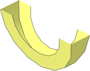

Needs 1 More Vote (CN)
Willy Tschager [Holly-Wood]
- No path of certified files to a certified or official parent in the parts folder
Max Murtazin [SwampKryakwa]
2022-03-18 15:30:02
Subpart for 47311
posted a vote of Hold
2022-04-02 09:45:01
* Flat prim scaled in y direction
* We don't have a specific rule for but the description should be:
Technic Bionicle Toa Metru Arm Lower Section with 2 Ball Joint - Curved Wedge Half
* Some spacing above and below the BFC command wouldn't hurt to structure the header a little bit. See examples in:
https://www.ldraw.org/article/398.html
2022-04-16 15:05:02
Fixed flat primitive Y scaling, removed unnecessary comments, changed description to match the standards
Existing certification-votes were deleted.
2022-04-16 21:10:01
Line 11: subfile unnecessarily scaled in the y dimension (x = 9.0, y = 2.9, z = 9.0)
1 16 0 0 4.1 9 0 0 0 0 9 0 -2.9 0 2-4edge.dat
2022-07-10 20:55:01
Fixed edge bleeding, old s02 not used anymore, s03 renumerated to s02
[PTadmin]
edited the part header.
2022-11-24 21:45:01
posted a vote of Certify
2022-12-05 21:30:02
made the following comment.
2022-12-26 20:00:01
Not truncated, just normal curved wedge, asking for file renaming
