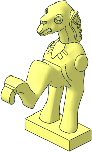

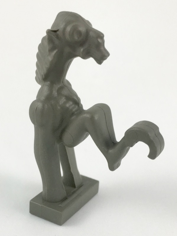

Amazing work. Nice to have this version in the library too.
Missing some condlines under the chin.
https://img.bricklink.com/ItemImage/EXTN/21234.original.png
https://img.bricklink.com/ItemImage/MN/0/sw0980.png
I think some lines are missing on his "ears", and maybe some ribs on the ribcage.
Those round things on his shoulders should maybe be softer? Loose the outer edge line?
Think we could use "Minifig Figure Sebulba" as the description.

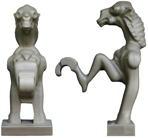

There is still something wrong with this...
I think maybe the neck, and the face, is too short. Could be more streched.

I totally agree that it's far from perfect. But I'm not sure what you suggest I change?
https://www.dropbox.com/scl/fi/qfkcvvq4hnggdi85mclpn/SebulbaWire.png?rlkey=t4uxle104vmmks06lfjct43nh&dl=0

hand should be clip
Orion Pobursky [OrionP]
made the following comment.
2025-02-14 01:35:27
Can't be. It's not a standard clip shape.

imho the hand should be able to hold clips
Jeff Jones [notmaster]
2025-02-14 11:13:16
*bars
2025-02-14 21:04:50
But it looks like a bar should be possible to snap into the clip.
Maybe add some cyli segments? Or some clean up inside the hand around a bar.
Where is the centre of that clip?
Fredrik Hareide [fhareide]
2025-02-15 06:13:22
New one yes. Old one not I think. https://www.flickr.com/photos/darthray/6906723249
2025-02-15 09:15:56
oh
2025-03-10 18:49:50
Just tested it on mine, the hands (or feet more likely) can definitely hold on to a 3.18 bar. It feels as firm as any other regular clip and he is even intended to hold on to his "controls" in the final build, so I guess this is very likely intentional.

should the bar connection for the feet be at 0 -45.5 -40?
2025-06-28 12:49:13
i should build sebulba's podracer and then find out
2025-06-28 13:21:24
updated
built it
the bar holder is at Y=-46 Z=-40
