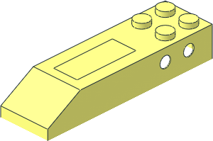

the floating 2 discs at the left side each should be converted into a very flat dish IMHO
Steffen [Steffen]
posted a vote of Hold
2024-02-15 18:30:52
the top hole for the red switch still needs to be modeled.
additionally it is too small, i.e. in its current size it just works for when the switch is NOT pressed.
but when you slightly rotate the switch so that it is either pressed down at the front or the rear part,
then the current hole is too small.

should the metallic insides be a separate part?
should the flat discs at the left side be replaced with bump5000? (but wider and flatter scaled)

got better pics and dimensions
when reworking, should the origin get moved to the center of the stud group? (also for the main part)

moved origin to top, separated contacts

corrected the vertical height of the middle hole (vertical distance at the triple is now 6 LDU)

* Correct me if I'm wrong. When you sub you get authorship of the sub.
2025-09-15 15:58:50
Steffen don't do it like that. Often keeping the original author in the new files.
As a separate part, the bottom edges are missing.

made it hollow and the switch cutout goes through now
