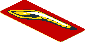

Unofficial File parts/6221654u.dat
Sticker  0.8 x  1.9 with Headlamp on Red Background Right
0 Sticker  0.8 x  1.9 with Headlamp on Red Background Right
0 Name: 6221654u.dat
0 !CATEGORY Sticker
0 !KEYWORDS 2017, 488, 63, BrickLink 75886stk01, Brickowl 731696
0 !KEYWORDS Christina Nielsen, Corsa, Ferrari, GT3, IMSA, Rebrickable 37800
0 !KEYWORDS Scuderia, Set 75886, Speed Champions
1 4 13.8789 0 0 0 0 1 0 1 0 -1 0 0 s\6221654us01.dat
1 4 13.8547 0 0 0 0 1 0 1 0 -1 0 0 s\6221654us02.dat
1 4 -.7172 0 0 0 0 1 0 1 0 -1 0 0 s\6221654us03.dat
1 4 -.7428 0 0 0 0 1 0 1 0 -1 0 0 s\6221654us04.dat
1 4 -14.6522 0 0 0 0 1 0 1 0 -1 0 0 s\6221654us05.dat
1 4 -14.681 0 0 0 0 1 0 1 0 -1 0 0 s\6221654us06.dat
1 16 0 0 0 1 0 0 0 1 0 0 0 1 s\stickerback008x019.dat

This is identical to 6221808bs.dat, apart from the background colour.
A set of uncoloured subfiles should be used, in a red and blue variant.
Massimo Maso [Sirio]
made the following comment.
2026-07-15 16:04:41
I agree with you. I had thought about it at the time of the first sending, but then I preferred to double them due to the fact that they belong to two different sets. Other parts are a bit different (such as the 6221654i and 6221808bg engine) and I wanted to leave the possibility to modify them independently in case of need.
if you are convinced i make them identical and delete the double subparts.
2026-07-15 18:04:39
2026-07-15 19:05:55
This is better. If any of the subs are reusable, please do so.
