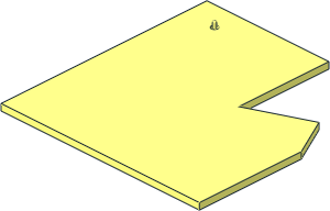

Not releaseable Needs 1 More Vote (CF) Needs 1 More Vote (CF)
Certify
Rene Rechthaler [Blechtaler]
2024-05-12 16:52:43
-made CCW
-applied rectifier
-with connector for u9226
-do we need more details? (most of them are inside and there are some holes with R1.5 LDU)
posted a vote of Certify
2024-05-31 15:26:43
Javier Orquera [kuramapika1]
Part Author
made the following comment.
2025-05-18 14:24:36
I would add, at least, the details of the moving red part (the one that allow to change rails).
2025-05-18 16:48:28
there is also a quite prominent cutout next to the box for the moving red part...
But that would require a rework of u9220 (s\864s01.dat)
one more thing I found: the slanted outside should be curved to match u9220, should that also be here?
2025-05-20 16:05:03
am thinking about adding this (and more details): should it be then also get unlinked from the original (renumber this to b and obsolete the official one)?
