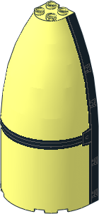

stickers might need rotation after final submission of a and c Sticker

changed orientation of the stickers to fit on this part with standard matrix
Orion Pobursky [OrionP]
posted a vote of Hold
2024-06-03 18:03:15
Per Gerald's comment, the sticker orientation changed and needs to be compensated for in this file.

Thanks, weil update the file

I did not touch the "b" Sticker yet, as it was official already, need to decide what to do.
Gerald Lasser [GeraldLasser]
2024-06-03 19:10:56
seems it was not submittred, I leave the b-sticer fornow as it was official we need to decide what to do

using correct stickers
posted a vote of Certify

stickers should be hardcoded white
its a transparent part, the stickers dont have BFC NOCLIP (because the sticker sheet is white)
or should they be hardcoded black? the set picture shows the rear side of the sticker black...

Where in the spec does it say it has to be white?

because paper stickers are normally white...
or is this a transparent sticker sheet? then the stickers need NOCLIP on the (fully printed) outside
does anyone have this Set? is this a transparent foil sticker sheet or a white paper sticker sheet?

There is noting wrong in this file, but the stickers should be bfc noclip.
The pattern is visible from the inside, in the video reviews I've seen.

ok i will cancel it if the stickers got BFC noclip added

@Rene, HOLD the sticker in question, the person who authored the sticker will not notice this hold here

the side stickers are official and need to be changed too...
(I guess the flat ones also count)

the adapted formed sticker (unofficial) now also needs BFC NOCLIP (edited the official ones)

ok all done
edited the part header.
