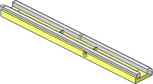

Unofficial File parts/862a.dat
Train Track 12V Straight Insert Type 2 with Isolation
0 Train Track 12V Straight Insert Type 2 with Isolation
0 Name: 862a.dat
0 Author: Steffen [Steffen]
0 !HELP There exist 2 more patterned variants of this part,
0 !HELP one with a black top triangle at the part center
0 !HELP and another with a black top triangle at one end
0 !HELP Note that the central underside rim fully extends
0 !HELP to the part bottom (different than 3240a, 3240b)
0 !CATEGORY Train
0 !KEYWORDS BrickLink 3242apb01, Rebrickable 3242d
0 !CMDLINE -c7
0 !HISTORY 2024-07-27 [Blechtaler] made CCW, used the fixes from 862ap01
1 16 0 0 0 1 0 0 0 1 0 0 0 1 s\862as01.dat
3 16 35 8 8 2 8 8 35 8 0
4 16 35 8 0 2 8 8 -2 8 8 35 8 -8
4 16 2 8 -8 35 8 -8 -2 8 8 -35 8 8
4 16 -2 8 -8 2 8 -8 -35 8 8 -35 8 0
3 16 -35 8 0 -35 8 -8 -2 8 -8
Rene Rechthaler [Blechtaler]
2024-07-27 13:22:10
fixed the underside (bottom stud with fillets) and some overlaps
made the following comment.
2024-07-27 13:37:33
Maybe the help info isn't needed anymore?
In all of these parts.
2024-07-27 14:36:09
I just realized that the bottom stud with fillets doesnt have the inside edgeline...
Do I need subparts (for everything except the arrow area)?
What about the !Help now? its quite useful to distinguish the versions...
2024-08-03 13:24:44
subfiled the base
