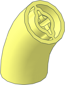

Any naming suggestion that makes sense and distiguishes it from 65473 is welcome
Philippe Hurbain [Philo]
made the following comment.
2024-08-15 12:48:17
I don't like very much the way the behaves with hires prim substitution. I think that less prims would be better there...
2024-08-15 12:49:26
(around axlehole and in the bottom of cavities)
Gerald Lasser [GeraldLasser]
2024-08-15 16:23:31
Yes, me too. Need to rethink this, probably use hires inlined
I made 65473 with to tori, but i only noticed now that you won't be able to mould the thing the way i drew it...
2024-08-15 16:24:40
I also found no wa, of using an axlehole prim (without duplicating surfaces} to get snap info for LDCAD
2024-08-17 12:36:33
Any comments to this design change?
https://www.patreon.com/posts/change-to-brick-98023623
Rene Rechthaler [Blechtaler]
2024-08-17 13:20:57
this one fits system (R80), the old one fits technic (same as connector #4)
2024-08-17 14:39:16
It's better to get automatic snapping thanks to prims, but when it doesn't work, adding snap information is not a hell to do ;)
2024-08-20 20:23:08
It is described as being 2x2 but it is only 1.9x1.9
Is the diameter correct?
2024-08-20 21:44:50
Diameter is taken from the app.
I think the description is fine with 2x2 as there are no other diameters, just the 3x3 as next size
2025-06-02 13:50:00
concerning automated snapping, axlehol0?
