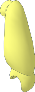

The hand seems to collide with a bar...
I'm missing a !HELP for exact position of a bar.

THe hand can hold a bar when the fig stands and has a bar fitted into 15712 on top of a 1x1 plate

I meant that the hand slightly collides with the bar (OK, not a big deal!)
I would still like a !HELP for bar position relative to arm to properly define hand connectivity.

OK, got you , will check

added help
