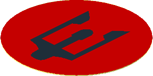

also misses the outer connection, should use 1-8chrd...
maybe use a half subfile?

to get an equal rim, I would suggest to scale the subpart to R10LDU and then scale it here x1.8 and in the 6451155a.dat x2.8
it could even use standard res in the subfile, the 6451155a.dat gets an additional aring...

Please use 1-8 and 1-4 chrds to properly pad the pattern into the circle

*bottom of trident misses an edge
*center tip of trident needs to be sharper
*why orient vertically? The real part has it at roughly 45 degree (needs to be measured likely)
*could be sub-filed to reuse for the color-inverted version in Set 8075
*I didn't check the entire Atlantis line, but it appears in multiple sets I'd say. Should the logo become a prim?

"*why orient vertically? The real part has it at roughly 45 degree (needs to be measured likely)"
This orientation is per spec. IF the real part has it rotated then it should be rotated on the shortcut.

Are you referring to this line of the spec (I couldn't find any other)?
"Top is defined as either the logical top of a picture, text, etc. or, in the case of more abstract patterns, what the top is when the sticker is applied."
My argument would be:
While it could be argued that the "logical" orientation of the trident would be upright, it contradicts the "applied" form. And this shape is technically a logo, not a "full trident".
This might be a redundant discussion, but I think in terms of geometry and rounding errors, having the base orientation match the applied version will cause less issues.
Should this be discussed in the forums?
made the following comment.
2025-10-25 02:23:30
Also it is printed on the sheet with 45 degree angle relative to the sheet's borders.

It hurts nothing to have the icon aligned to the axes. This is the correct orientation. How it's printed is irrelevant.
2025-10-25 02:42:22
Ok I'll take it back - I found this 59231pb03 having the logo upright.
This pattern still has other issues though.

I see no reason for having a hi-res back side.

yes, just subfile the logo and use (normal res) prims outside

modified pattern and put in in logo prims

should the title get corrected? (headeredit)
