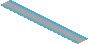

0 Sticker 0.8 x 5.8 with Light Bluish Grey Stripe on Dark Azure Background
0 Name: 6228775v.dat
0 !CATEGORY Sticker
0 !KEYWORDS Bricklink 42083stk01, Brickowl 885585, Bugatti Chiron, Lego Technic
0 !KEYWORDS Rebrickable 38973, set 42083
0 !HISTORY 2025-08-02 [jb70] Using stickerback subfile
1 16 0 0 0 1 0 0 0 1 0 0 0 1 s\stickerback008x058.dat
0 // Sticker-Front
1 321 -56.5 -.25 6.5 -1.5 0 0 0 1 0 0 0 1.5 1-4chrd.dat
1 321 56.5 -.25 6.5 1.5 0 0 0 1 0 0 0 1.5 1-4chrd.dat
1 321 -56.5 -.25 -6.5 -1.5 0 0 0 1 0 0 0 -1.5 1-4chrd.dat
1 321 56.5 -.25 -6.5 1.5 0 0 0 1 0 0 0 -1.5 1-4chrd.dat
4 321 58 -.25 6.5 -58 -.25 6.5 -58 -.25 4.5 58 -.25 4.5
4 321 58 -.25 -6.5 58 -.25 -4.5 -58 -.25 -4.5 -58 -.25 -6.5
4 321 58 -.25 -6.5 -58 -.25 -6.5 -56.5 -.25 -8 56.5 -.25 -8
4 321 58 -.25 6.5 56.5 -.25 8 -56.5 -.25 8 -58 -.25 6.5
4 71 58 -.25 4.5 -58 -.25 4.5 -58 -.25 -4.5 58 -.25 -4.5

posted a vote of Hold
2024-10-21 16:36:06
Wrong blue used. The parts in this set are Dark Azure or Dark Blue.
Australian spelling of all word is always used. Gray has to be Grey.
On the sticker sheet this sticker is marked as number 22. Then it should use the code letter v, since v is the twentysecond letter in the alphabet.
made the following comment.
2024-10-21 20:18:20
I think I have corrected all stickers now, except this one.
You need to use the correct code letter, according to the sticker sheet.
Rene Rechthaler [Blechtaler]
2024-10-21 20:43:02
please use 1-4chrd.dat at the top
and a vertex mismatch causes a gap between the 2 long triangles at the top (should get fixed and merged)
2024-10-21 20:48:20
Why are those triangles not joined as a quad?
2024-10-21 21:23:44
2024-10-22 21:49:14
@Magnus:
- Color changed to dark azure.
- Deeply sorry for all the code letters mistakes. I’m aware of the code letters. I’ve read the specification carefully. Just forgot that to change it in some of the stickers. Thanks you very much for correcting.
@Rene:
- Changed to 1-4chrd primitves (strange in LDPC I’ve used those primites).
@Rene & Magnus:
Vertex mismatch gap closed and I’ve used a quad instead.
@Rene
I’m using the the dropbox stickers from you, Gerald and Stephan (Links from Tchang). Thanke nevertheless.
@Rene:
@Rene & Magnus:
@Rene
2024-10-22 21:51:00
Forgot to adapt the description (Dark Azure instead of Blue)
Orion Pobursky [OrionP]
2024-10-22 22:06:42
No worries about the letters and no need to apologize. It's an easy fix and this is how we learn.
2024-10-23 16:32:25
As I said above:
Australian spelling of all word is always used. Gray has to be Grey. And here it need to be "Light Bluish Grey".
2024-10-25 16:17:35
Edited Description.
Jens Brühl [jb70]
2025-08-03 17:33:15
I used a new stickerback subfile and changed size from 0.9 x 5.9 to 0.8 x 5.8.
