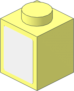

This is a very odd usage.
The backside of this sticker is the "pattern" that create a white surface, viewed through the trans yellow brick.
Does it need to be bfc noclip?
Or do we hard code it, to have a white backside, in this shortcut?
made the following comment.
2024-10-26 08:58:04
For those who wants to have a closer look how the sticker is used: Instruction page 268 e.g. step 389 or speeedbuild at min 07:30 (https://www.youtube.com/watch?v=fM1Gw1UM6-4). I would tend to white backside.
Gerald Lasser [GeraldLasser]
posted a vote of Certify
2025-02-18 13:50:04
2025-02-18 14:32:17
Orion Pobursky [OrionP]
posted a vote of Hold
2025-03-14 18:37:51
"Does it need to be bfc noclip?
Or do we hard code it, to have a white backside, in this shortcut? "
I'd say both.
I'd say both.
Rene Rechthaler [Blechtaler]
2025-06-16 20:39:33
I would say hardcoding white is enough, doesnt look like a transparent sticker sheet...
2025-06-16 21:03:52
Definitely needs to be hardcoded white.
I checked with the Library's 3D viewer and no NOCLIP is fine. How does LDView behave without NOCLIP? If it's fine then no NOCLIP needed.
2025-06-16 21:26:46
I couldn't tell any difference here, if NOCLIP is used or not in LDView, but it still looks awkward in both cases if the back isn't white.
