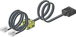

Unofficial File parts/61930.dat
0 Electric Power Functions Light Unit with Black Coiled Cable
0 Name: 61930.dat
0 Author: Trevor Sandy [bootknuckle]
0 !CATEGORY Electric
0 !KEYWORDS Bricklink 61930c01, Peeron x1917cx1
0 !HISTORY 2024-12-09 [bootknuckle] adapted from shortcut 22168.dat
0 // Middle Box
1 16 0 0 0 1 0 0 0 1 0 0 0 1 62501c01.dat
0 // Main Cable and Plug
1 256 0 12 16.4 1 0 0 0 1 0 0 0 1 u9190c01.dat
0 // Twin Cable
1 256 3 12 -12 1 0 0 0 1 0 0 0 1 s\61930s01.dat
0 // LED Light
1 47 23 -2.8 -115.5 1 0 0 0 1 0 0 0 1 62498c02.dat
0 // Twin Cable
1 256 -3 12 -12 -1 0 0 0 1 0 0 0 1 s\61930s01.dat
0 // LED Light
1 47 -23 -2.8 -115.5 1 0 0 0 1 0 0 0 1 62498c02.dat

Rene Rechthaler [Blechtaler]
made the following comment.
2024-12-13 12:14:04
you could use u9190c01.dat (no need to make an own cable...)
or maybe use u9190.dat (same cable segment, but open)
and watch out for the subpart links, you use both / and \ (both work, but / causes errors)
2024-12-13 14:04:08
Understood. I've corrected all occurrences of / to \.
The u9190 segment is incompatible with Light Middle Box 62501c01.
Light Middle Box 62501c01 uses the u9028 segment, I could not find one that uses u9190 - do you know if one exists ?
Similarly, I could not find a Light with Cable Horizontal using the u9190 segment, 62498c02 uses u9028.
Using s\58124s03 maintains the pattern used by the other Electric Power Functions 58...parts.
Cheers,
Cheers,
posted a vote of Hold
2024-12-13 15:29:43
u9190.dat (https://library.ldraw.org/parts/15838) is the same as the s\58124s03.dat (https://library.ldraw.org/parts/19523) without the closed end.
u9190.dat is used in u9190c01.dat (https://library.ldraw.org/parts/15839), which itself is used for the other PF shortcuts (motors and extension).
this saves some code by not needing to model the full coil in every part.
and the middle box is black again now... (should be color 16)
2024-12-13 17:00:05
Replace s\58124s03 Main Cable segments with u9190c01 Main Cable and Plug and set Middle Box color to 16
2024-12-13 17:05:48
much better, but the origin is off (the center brick should be at 0 0 0)
2024-12-13 17:07:14
| ...u9190.dat is used in u9190c01.dat
Indeed. On my initial attempt to use u9190c01, it seemed like the individual main cable disc diameter was smaller than those fitted to the middle box. On taking a second look, this was not the case.
Cheers,
Cheers,
2024-12-13 17:38:18
Set Middle Box origin to 0 0 0
2024-12-13 17:42:51
see, now all coordinates are nice even values and symmetric...
2024-12-13 17:46:38
Yep - I used LeoCAD so I didn't have the support of a true authoring package. Many thanks for your review.
Cheers,
posted a vote of Certify
2024-12-13 18:00:19
for parts, LDPE (LDrawPartsEditor) is better...
maybe do the other not-yet-cabled PF shortcuts next?
@admin: maybe add the Keywords: peeron x1917cx1, Bricklink 61930c01, Rebrickable 61930, Brickowl ID 344712-38 (also has 16516 as Lego ID)
2024-12-14 14:12:53
| maybe do the other not-yet-cabled PF shortcuts next ?
These parts appear to not have cabled shortcuts. Is this list exhaustive ?
- 87577 Electric, Motor 9V Power Functions with Gear Reduction Ratio 9.5 : 1
- 87574 Power Functions Train Motor
- 63523 Electric Sensor, Motion - WeDo Robotics
- 63521 Electric Hub, USB - WeDo Robotics
Cheers,
Cheers,
2024-12-14 14:38:42
watch out: the WeDo sensord have a shorter cable and the flat connector...
the IR receivers also seem to miss the cabled versions.
2024-12-14 14:44:26
hm, scrap the "shorter cable" comment... (guess you can still edit the cable shortcut for the sensors, just swap the plug)
the pole reverser also misses the cabled shortcut.
2024-12-14 14:56:19
the IR Receivers and the pole reversers have two variants each...
2024-12-15 15:07:51
A shortcut can only be made from other parts. This file is using a subfile twice. The only exeption to this is part 22168.
The other shortcuts including a cable are all XXXXXc01. This one, and 22168, isn't.
Why?
Why?
2024-12-15 15:14:36
because this subpart is only used here...
all other cabled shortcuts are part shortcut+cable shortcut.
this one has the thin coil which is used only in this shortcut, so its a part-shortcut-subfile...
2024-12-15 15:37:43
So what must be done to unblock the error ? Should subfile s\61930s01 be renamed to a u... part ?
Cheers,
Cheers,
