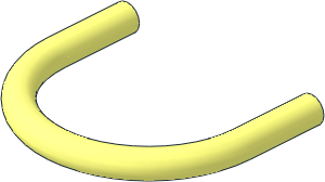

Unofficial File parts/76289-f1.dat
Technic Flex-System Hose  7L (140LDU) - Curved R30
0 Technic Flex-System Hose  7L (140LDU) - Curved R30
0 Name: 76289-f1.dat
0 !HELP To use this part:
0 !HELP Create a group with 24333 and 76289-f1 in this positions
0 !HELP 1 16 -30 0 0 0 0 1 1 0 0 0 1 0 23443.dat
0 !HELP 1 16 30 0 0 0 0 1 1 0 0 0 1 0 23443.dat
0 !HELP 1 16 0 0 -20 1 0 0 0 1 0 0 0 1 76289-f1.dat
0 !HELP Then rotate the group around the X axis (centre of Bar Tube) of following angles
0 !HELP for set 76898: 6.584 degrees
0 !HELP for set 76909: 9.268 degrees
0 !HELP for set 76919 and 76925: 12.067 degrees
0 !CATEGORY Technic
0 !KEYWORDS F1, Formula 1, HALO, Set 76898, Set 76909, Set 76919, set 76925
0 !KEYWORDS Speed Champions
1 16 -30 0 0 1 0 0 0 0 -1 0 -22.8761 0 u9053.dat
1 16 30 0 0 1 0 0 0 0 -1 0 -22.8761 0 u9053.dat

Massimo Maso [Sirio]
2025-02-02 09:38:38
Rene Rechthaler [Blechtaler]
made the following comment.
2025-02-02 10:34:17
where/how do you need/use that?
2025-02-02 10:55:34
In all the Speed Champion F1 cars.
Add some keywords?
2025-02-02 11:08:25
for the Halo? that should be added too as a keyword (together with Speed champions + F1)
maybe also an !Help for the placement?
Gerald Lasser [GeraldLasser]
2025-02-02 12:16:52
as Rene said a !HELP would be perfect for this.
add the relevant end parts in the help lines, are they using multiple ways of fixing this? I have only one car...
edited the part header.
2025-02-02 12:17:21
Header Edits
keywords:
to
HALO, Speed Champions, Formula 1
2025-02-02 21:44:50
Header Edits
help:
0 !HELP
to
0 !HELP for set 76919: 12.067 degrees
0 !HELP for set 76925: 12.067 degrees
keywords:
Formula 1, HALO, Speed Champions
to
Formula 1, F1, HALO, Speed Champions, set 76898, set 76909, set 76919, set 76925
2025-02-03 11:43:10
I would include the placement including the 23443 parts
Currently the origin of the part is at its ends, in the final set the rotation is around th bar end of the 23443. so IMHO a helpp line lke this would be good for the different angles
i.e. appling the rotation to these three parts
1 16 -30 0 0 0 0 -1 -1 0 0 0 1 0 23443.dat
1 16 30 0 0 0 0 -1 -1 0 0 0 1 0 23443.dat
1 16 -30 0 -20 0 0 -1 -1 0 0 0 1 0 76289-f1.dat
2025-02-03 19:27:08
Header Edits
help:
to
keywords:
F1, Formula 1, HALO, Set 76898, Set 76909, Set 76919, set 76925, Speed Champions
to
F1, Formula 1, HALO, Set 76898, Set 76909, Set 76919, Speed Champions, set 76925
2025-02-03 19:29:07
Added the building tips.
In the next days, when available, I will add similar information for sets coming in 2025:
77242 Ferrari SF-24 F1
77243 Auto da corsa Oracle Red Bull Racing RB20 F1
77244 Mercedes-AMG F1 W15
77245 Aston Martin Aramco F1 AMR24
77246 Visa Cash App RB VCARB 01 F1
77247 KICK Sauber F1 Team C44
77248 BWT Alpine F1 Team A524
77249 Williams Racing FW46 F1
77250 MoneyGram Auto da corsa Haas F1 Team VF-24
77251 McLaren F1 Team MCL38
