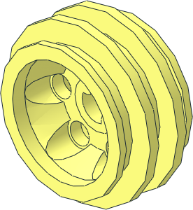

Not releaseable Errors Found (CHN) Errors Found (CHN)
Hold
Certify
Rene Rechthaler [Blechtaler]
2025-03-16 21:44:53
rotated the spokes/holes to match the 32146 and the real part
made the following comment.
2025-03-16 22:01:04
the real part has the spokes differently oriented to the axlehole compared to the official part...
should the old official part now become a Moved to or just obsoleted?
posted a vote of Certify
2026-08-29 19:04:01
posted a vote of Hold
2026-08-30 12:19:29
I see no reason for a b-version. You can get the same result by rotating only the axle hole primitive by 90 deg.
2026-09-02 13:50:44
the idea was also to have the spokes aligned to the solid version 32146 (that one is also reworked, could put the alignment there)
