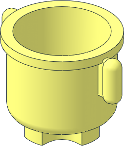

Unofficial File parts/31042.dat
Duplo Pot  2 x  2 x  1.5  with Handles
0 Duplo Pot  2 x  2 x  1.5  with Handles
0 Name: 31042.dat
0 !CATEGORY Figure Accessory
0 !HISTORY 2025-01-30 {LEGO Instructions App} Original part shape
0 !HISTORY 2025-01-30 [GeraldLasser] File preparation for LDraw Parts Tracker

Not releaseable Errors Found (CHN) Errors Found (CHN)
Hold
Certify
Peter Blomberg [WUIt]
  • Invalid Line
    Line 50: 1 16 0 -72. 0 8 0 0 0 1 0 0 0 8 48\4-4ring4.dat
Gerald Lasser [GeraldLasser]
2025-03-31 16:43:24
made the following comment.
2025-04-09 09:48:35
The part height is off by 0.5 LDU. It is supposed to fit 1.5 brick heights (1.5*48 = 72). The following ring should be lowered to -72.
1 16 0 -72.5 0 8 0 0 0 1 0 0 0 8 48\4-4ring4.dat
Philippe Hurbain [Philo]
posted a vote of Hold
2025-04-09 12:31:48
Holding to make sure Gerald sees that ;)
2025-04-09 12:54:14
Thanks for holding, otherwise I would skip it... :-)
2025-04-09 12:58:21
Lowered Top
posted a vote of Certify
2025-04-11 06:48:06
2026-09-10 19:26:11
There's a stray point after -72
