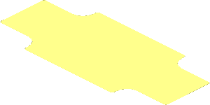

Inlined Top Surface
Jens Brühl [jb70]
2025-08-02 12:48:49
Prims are back. Got lost while inlining.
made the following comment.
2025-08-02 14:35:14
I agree, maybe...
This is "formed" to only fit that part, 64782, and I think it should have the bXX-suffix even if it is flat.
OTOH
stickerback048x108 is the name to use if we should follow the spec.
OTOH
Jens Brühl [jb70]
2025-08-02 14:43:11
But this shape is irregular and not Quadrilateral.
And I think, irregular shaped formed stickers should not only have a formed stickerback, but also a flat one, that should follow the same naming conventions as the formed ones, if they are designed to be attached to a specific part.
2025-08-02 15:04:57
Yes, this needs some sort of indicator for being irregular.
Orion Pobursky [OrionP]
2025-08-02 15:48:23
This is not a formed sticker back. However, with the new revision, it can be renamed to stickerback048x108a
renamed the part.
2025-08-02 17:11:10
"parts/s/6154914fs01.dat" to "parts/s/stickerback048x108a.dat"
Jens Brühl [jb70]
2025-08-03 21:59:24
Added HELP with link to the part this stickerback should be attached to
Even, if it is not a formed sticker, should we use the same naming convention as for formed stickers?
If you agree, you could you rename this part to 64782b01.dat
