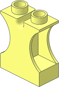

Unofficial File parts/42234.dat
0 Duplo Brick 1 x 2 x 2 with Scooped Sides without Bottom Stud
0 Name: 42234.dat
0 !CATEGORY Brick
0 !KEYWORDS Brickowl 629395
0 !HISTORY 2013-02-23 [Philo] Rebuilt "waist" hi-res.
0 !HISTORY 2025-04-30 [WUIt] CCW'd BFC, fixed flat subfile scaling
0 !HISTORY 2026-07-11 [MagFors] subfiled for part variant
1 16 0 0 0 1 0 0 0 1 0 0 0 1 s\42234s01.dat
1 16 11 74 -13 1.5 0 0 0 17 0 0 0 3 box4-1.dat
1 16 -11 74 -13 1.5 0 0 0 17 0 0 0 3 box4-1.dat
1 16 11 74 13 1.5 0 0 0 17 0 0 0 -3 box4-1.dat
1 16 -11 74 13 1.5 0 0 0 17 0 0 0 -3 box4-1.dat

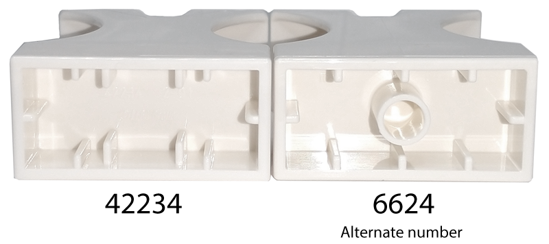

Rene Rechthaler [Blechtaler]
made the following comment.
2026-07-10 20:14:34
BL says there are 2 similar parts (not just an alias) with different bottom designs -> subpart?
https://img.bricklink.com/ItemImage/EXTN/82897.png
2026-07-11 17:15:54
Are we sure the hole is sized correctly?
See https://library.ldraw.org/parts/49915
2026-07-11 18:11:17
