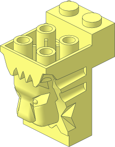

Needs 2 More Votes (N)
No recorded votesThis part has the following automated holds from the Parts Tracker
Has Uncertified Subfiles
Massimo Maso [Sirio]
2025-05-25 09:52:33
Jeff Jones [notmaster]
made the following comment.
2025-05-25 10:10:24
note the id associated is for a variant with soild studs removing a connection point
2025-07-08 22:36:41
so this should not be a alias
posted a vote of Hold
2025-07-08 22:39:25
Agreed.
Asides the studs, there are also changes to the front of lion's mane made. And the front hollow studs seem different. Do the added reinforcements need to be modelled?
Rene Rechthaler [Blechtaler]
2025-07-08 22:48:23
yes, should be a numbered variant instead of an alias -> subfile everything but the upper two studs and add solid studs here and hollow ones in the original.
while the sub is on the tracker, it could be reworked -> nose misses a condlines, inner stud extension tubes have holes around...
2025-08-19 14:54:39
bump
2025-09-08 23:29:45
Orion Pobursky [OrionP]
edited the part header.
2025-09-09 18:06:31
Header Edits
description:
Brick 3 x 2 x 3 with Lion's Head Carving and Cutout with Solid Studs
to
Brick 3 x 2 x 3 with Lion Head Carving and Cutout with Solid Studs
