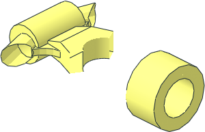

Certify
Philippe Hurbain [Philo]
Franklin W. Cain [fwcain]
Part Reviewer
2025-06-06 17:57:32
Rene Rechthaler [Blechtaler]
posted a vote of Hold
2025-06-06 21:28:48
the bottom of the central hole needs to be in the main part, should be excluded from the subpart and added here
(delete the inner hole and the surrounding faces here and add it in the main part)
and there are overlaps in the sloped cyl segments at the sides
2025-12-06 19:55:40
A complete rework based on new digital data.
2025-12-07 17:20:48
Removed the tiny offset of bars and holes. All now at Y=2
2025-12-08 07:47:16
Missing condline here:
5 24 12.95 -2 0 12.96 -2.30464 0 12.96047 -2.25472 2.25555 12.96047 -2.25472 -2.25555
2025-12-08 17:55:07
Removed problem.
posted a vote of Certify
2025-12-08 19:42:25
