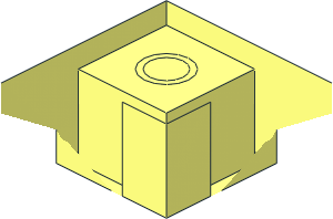

Unofficial File parts/s/30489s02.dat
~Brick Sports Field Section - Corner
0 ~Brick Sports Field Section - Corner
0 Name: s\30489s02.dat

2025-07-19 04:36:06
*corrected center pin height and length
*corrected dimple diameter
*corrected underpin positions
*added bottom chamfers and top cutouts (plate removal helpers)
*added stud connector ribs in side cavities
*sub-filed patternable area
*reworked main geometry from scratch to remove various smaller issues
*sub-filed to re-use in 30492 and 41819
There is a small overlap on the bottom, between the dimple and the center anti-stud. Not sure if that is problematic enough to rework that area.
