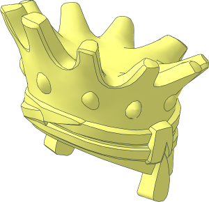

Subjectively, I would find the same pattern of edge lines on the crown tips more appealing. Now there are some tips with only one set of edge lines while others have 1,5 or 2 sets of edge lines.

Copy some of the lines you see as a good, or bad example, and paste them here.
Helps us to see what you don't like.
Peter Blomberg [WUIt]
made the following comment.
2025-10-23 23:06:34
The tip in front and centre has these lines:
2 24 2.679 -24.228 -20.796 3.182 -21.904 -19.844
2 24 3.182 -21.904 -19.844 4.171 -20.122 -18.98
2 24 2.384 -29.067 -22.705 2.477 -26.655 -21.75
2 24 2.477 -26.655 -21.75 2.679 -24.228 -20.796
2 24 1.336 -30.32 -23.89 2.39 -30.397 -23.235
2 24 2.39 -30.397 -23.235 2.384 -29.067 -22.705
2 24 4.171 -20.122 -18.98 5.473 -19.4 -18.344
2 24 0 -30.354 -24.174 1.336 -30.32 -23.89
On the side, one tip has these lines:
2 24 13.867 -14.642 -10.411 14.753 -14.649 -9.092
2 24 14.753 -14.649 -9.092 16.17 -15.465 -7.995
2 24 17.377 -16.684 -7.471 18.914 -18.777 -6.998
2 24 16.17 -15.465 -7.995 17.377 -16.684 -7.471
2 24 18.914 -18.777 -6.998 19.788 -20.27 -6.646
2 24 19.788 -20.27 -6.646 19.918 -20.838 -6.466
Next to it, the tip has these lines:
2 24 14.517 -7.51 10.15 13.659 -6.878 10.913
2 24 17.672 -10.765 9.95 15.727 -8.782 9.868
2 24 15.727 -8.782 9.868 14.517 -7.51 10.15
2 24 19.881 -12.96 10.544 17.672 -10.765 9.95
2 24 20.135 -13.444 10.574 19.881 -12.96 10.544
The latter two lines connect to the top ring of edgelines instead of having that horizontal segment visible on the front centre tip.
