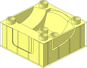

Needs 2 More Votes (N)
No recorded votesThis part has the following automated holds from the Parts Tracker
- No path of certified files to a certified or official parent in the parts folder
Has Uncertified Subfiles
Gerald Lasser [GeraldLasser]
2025-09-29 22:14:45
Peter Blomberg [WUIt]
posted a vote of Hold
2025-10-01 14:30:49
Rene Rechthaler [Blechtaler]
made the following comment.
2025-10-01 16:03:06
looks even the rear side is printed too (not together, but in separate parts)
are the front/rear recessed cutouts identical? maybe cut that out from the half subpart and create a new front subpart
(which then gets also mirrored to the rear, except for the cases its printed)
2025-10-01 17:09:38
YEs, seems three sides are the most, could not find one where all four sides are printed
cancelled their vote.
2025-10-03 10:58:16
2025-11-17 17:56:28
Color error on lines 54 and 55.
At the same time, revise the subparting to cater all pattern combinations
2026-03-23 13:08:59
corrected line colour
reorganized for front/back Print
2026-03-23 16:56:18
Missing an edge line between the seat and the backrest.
2026-03-24 09:24:31
added edge line
https://rebrickable.com/parts/51547/duplo-train-cab-tender-base/
