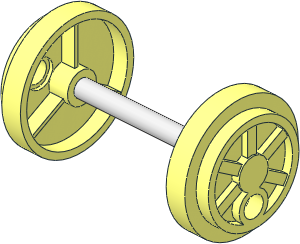

Note: The wheels are oriented differently on all the assemblies I have
Rene Rechthaler [Blechtaler]
made the following comment.
2025-10-06 22:59:36
just left/righthand mirrored or also different angles? how hard is it to manually rotate the wheels on the axle?
(geometrically, it should be 90° or 180°, realistically your 120° are right...)
Gerald Lasser [GeraldLasser]
2025-10-07 22:11:05
You can Rotate tehm on the axel, tough, but yes
Peter Blomberg [WUIt]
2025-10-10 20:07:57
They should be at a 90 deg angle for physical correctness.
