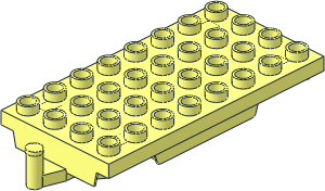

31300 is the top part in 76349, without reinforced hook

91793 is the top part in 91794, with reinforced hook

Isn't it missing some kind of bumpstop, or angle stopper?

is the reinforcement at the hook the only difference? when flipping between the Brickset images, the hook base also seems slightly different...

@Magnus, thanks for the number, spared me cutting one more apart...
Yes, Bumpers are missing, I was going to reuse the ones from 2960, but apparently they are different in size and I forgot to change them.
@Rene, yes, it seems so. I have both versions, but I did only open the 91794 assembly, but from the outside they look the same. I need to check the bottom of the hook, those are slightly different and I once I am done with them, we need to review the hook prim and I probably need to tweak the affected parts a bit.

"parts/91793.dat" to "parts/31300.dat"

what I cannot tell is which movable hitch is used in the odler one. It is no RTZ hitch for sure, but it is anyway invisible... unless you render it transparent

This number belongs to the one with the reenforced ´hook
