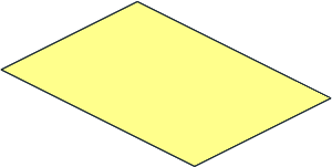

Sheet Paper 18.5 x 26.3 (ISO A5)
0 Sheet Paper 18.5 x 26.3 (ISO A5) 0 Name: u1049.dat 0 Author: Takeshi Takahashi [RainbowDolphin] 0 !LDRAW_ORG Unofficial_Part 0 !LICENSE Licensed under CC BY 4.0 : see CAreadme.txt 0 BFC CERTIFY CCW 0 !CATEGORY Sheet Cardboard 0 !KEYWORDS Bricklink bb0094, Brickowl 635042, Control Center, Peeron x1049 0 !KEYWORDS Plotter, Rebrickable upn0130, Set 8094, Sketch pad
1 16 0 -.125 0 262.5 0 0 0 .125 0 0 0 185 box.dat

2025-11-02 04:15:25
Is the category correct?
Philippe Hurbain [Philo]
made the following comment.
2025-11-02 08:08:41
Category looks good... You're going to model the Control Center set?
2025-11-02 14:59:51
Thanks, and corrected the size
2025-11-03 17:08:41
This is a Peeron partnumber. Should we really use them?
Rene Rechthaler [Blechtaler]
2025-11-03 18:28:23
full edgelines? or none like stickers? (has the same .25 thickness)
2025-11-03 19:06:35
U+peeron number used to be the way to go...
This is a standalone part, so needs edge lines. They are suppressed for stickers since they are too prominent when applied on a part.
2025-11-03 19:14:54
is this even an u-number? or should it be a t-number?
(edgelines are also very prominent here, maybe too much)
Orion Pobursky [OrionP]
2025-11-03 19:17:45
t is not appropriate so u number is fine for this.
2025-11-03 19:18:47
it could also be used for Set 1092-E (electronic plotter)
2025-11-03 19:24:03
sorry Dacta Technic 1092-A is the plotter (uses the same 24x24 plate 367)
2025-11-04 19:02:42
Did these come loose or like a bound pad?
2025-11-04 19:42:06
BL says a pack of loose sheets...
(no count stated)
would it be ok to create a "shortcut" for that stack made of a single higher box?
2025-11-04 21:33:08
According to the stated weight that would be roughly 20-30 sheets (though the accuracy of that statement might be debatable).
I found an image on Ebay that seems to confirm the BL image as loose sheets. I am surprised though that the build seems to work better with a stack than a single sheet...
BL doesn't have separate entries for block and sheet. Still add the link for bb0094?
https://www.bricklink.com/v2/catalog/catalogitem.page?G=bb0094&idColor=0#T=S&O={%22iconly%22:0}
2025-11-04 21:49:20
What model use is a stack of sheets? Presumably they're used one at a time.
2025-11-04 22:47:41
http://www.peeron.com/scans/8094-1/28
I was a little mistaken by the last page of the instructions, where it looked like the clamps at the back of the plate would work better with multiple ones instead of a single one. I didn't see the rubber band holding it in place, so it should work with a single one too.
They still imply to use multiple ones.
If they are loose, I don't think there's a point in a shortcut.
2025-11-04 23:55:38
using multiple sheets makes drawing easier because then the pen doesnt scratch that much on the hard baseplate...
I would suggest to use a box5-12.dat with a quad (like a sticker), then stacking wont be a problem (as of now you will get solid black sides from the many stacked edgelines)
could then even do some fake used sheets with circles (from the two-wheeled A model) and one with lines (B Model Plotter) like a sticker
2025-11-05 00:11:05
I don't want to fall down this rabbit hole too far for a non-LEGO object. I think 1 sheet is fine. Edge line or no can still be discussed. I'm leaning towards edge lines.
2025-11-05 06:54:24
A simple solution. Scale the single sheet on y-axis to simulate a stack of papers.
2025-11-05 10:02:45
I built that plotter (a wile ago...), it worked fine with a single sheet!
