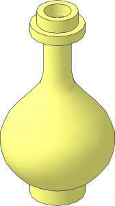

Minifig Bottle Florence Flask with Inside Trans-Yellow Fluid
0 Minifig Bottle Florence Flask with Inside Trans-Yellow Fluid

posted a vote of Hold
2025-12-15 17:31:01
Minifig Accessory is the Category.
This should be Minifig Flask or Minifig Bottle, and a description of the shape.
The other words could be Keywords. Or are they commonly used to describe the shape?
Origin is off.
All trailing 0 (zero) most be removed.
The 12-sided ldd mesh should at least be upscaled to a 16-sided design.
Using many cone-prims might look good, in normal resolution, but breaks in hi-res.
Based on the images, I think this should be made like u9181c01.dat, but that was done before we understood and formulated the dual mould practice
Rene Rechthaler [Blechtaler]
made the following comment.
2025-12-15 19:19:18
this part is quite ok except name/category, almost all big errors are in the subparts
the base part code here seems ok
2026-07-02 15:38:38
How about:
Minifig Accessory Bottle / Erlenmeyer / Florence Flask with Inside Trans-Yellow Fluid Pattern
2026-07-02 15:39:26
Accessory should be removed from the description
2026-07-02 15:42:56
Erlenmeyer / Florence ?
Erlenmeyer is a conical flask. I think it should be removed from the description
2026-07-02 15:44:03
Why both Flask and Bottle? It should be one of them.
edited the part header.
2026-07-04 08:23:04
Header Edits
description:
Minifig Accessory Bottle / Erlenmeyer / Florence Flask Trans-Yellow Fluid Pattern
to
Minifig Bottle Florence Flask with Inside Trans-Yellow Fluid Pattern
2026-07-04 20:32:31
Header Edits
keywords:
Bricklink 5608PB01, Brickowl 605413, Brickset 5608, Rebrickable 5608pat0001, Set 40230, Set 76431
to
Set 40230, Set 76431, Colour Combination, Bricklink 5608PB01, Brickowl 605413, Brickset 5608, Rebrickable 5608pat0001
description:
to
