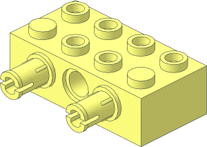

Not releaseable Awaiting Admin Review (CCN) Awaiting Admin Review (CCN)
Certify
Vincent Messenet [Cheenzo]
Certify
Rene Rechthaler [Blechtaler]
Philippe Hurbain [Philo]
2026-02-06 16:55:53
posted a vote of Hold
2026-02-06 16:57:35
Part number needs confirmation, the photo I used seems to show 112174.
2026-02-06 17:12:42
Added missing ribs
2026-02-06 17:13:14
restoring hold
2026-02-06 22:11:58
hold: pins miss the inside edgelines to the brick surface
not hold, just weird: I dont think the s01 connects to the 2-4stud4 only at edge connections...
would 2x 3-16 or 1-8 fit better?
Gerald Lasser [GeraldLasser]
made the following comment.
2026-02-06 22:34:35
Is this from the education Sets?
2026-02-06 22:44:37
yes from the one with the rails
2026-02-07 07:45:53
- Added missing pin bottom edge lines (and corrected wrong orientation!)
- The stud4 junction looks _almost_ like that, so let's keep things simple and efficient!
2026-02-07 07:47:05
restoring hold
edited the part header.
2026-02-12 07:39:49
Header Edits
keywords:
to
Education, Science, Computer and AI
2026-02-13 13:00:59
Header Edits
keywords:
Computer and AI, Education, Science
to
cancelled their vote.
2026-04-01 07:55:44
Now released.
posted a vote of Certify
2026-04-01 10:17:14
some t-juncs at the pinhole ndis, but not that critical here
