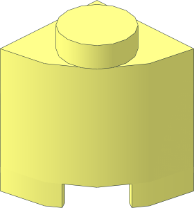

Gerald Lasser [GeraldLasser]
2026-02-28 16:11:07
Rene Rechthaler [Blechtaler]
made the following comment.
2026-02-28 16:14:49
thanks for not using the round cutout
2026-02-28 19:40:24
I took the cutout from 1871 as it is quite tight, otherwise it would not fit
need to add that in the history
2026-02-28 19:48:05
ah I also used that one in 7525
2026-02-28 22:41:21
i think you could even reuse 1871s02 here...
https://library.ldraw.org/parts/50835
2026-03-01 00:47:32
Does an unprinted part need an external link keyword?
2026-03-01 00:57:04
@rene, indeed!
@chris, this seems to be added automatically by the rebricakble API. BO has their own numbers.
2026-03-01 01:04:25
used subfiles as advised
2026-03-01 11:00:22
should there be an 1-4 chrd under the stud? or why the triangle+quad?
