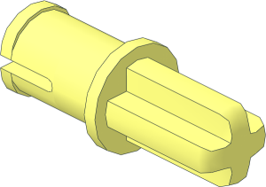

Rene Rechthaler [Blechtaler]
2026-06-02 11:02:12
made from the normal 3749 axle pin with an inlined and edited connect10
made the following comment.
2026-06-02 11:03:47
this part is supposed to be used in the wheel assemblies with non-removable pins, should these also be here (as complete shortcut?)
https://rebrickable.com/parts/116980/wheel-assembly/
Gerald Lasser [GeraldLasser]
2026-06-11 10:55:29
I think connectcollar1 is better as it has a shorte slit
2026-06-11 15:12:44
shorter pin slit (with connectcollar1)
