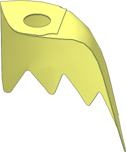

Unofficial File parts/71941c01.dat
Minifig Cape Cloth with 5 Points (Triangular) (Formed)
0 Minifig Cape Cloth with 5 Points (Triangular) (Formed)
0 Name: 71941c01.dat
0 !HELP Place at y = 0 on torso, head at y = -0.6
0 !CATEGORY Minifig Neckwear
0 !KEYWORDS Achu, Adventurers, cape, Jungle God Cloak, Set 5906, set 5976
0 !KEYWORDS set 5986
0 // Neck
1 16 0 0 0 1 0 0 0 1 0 0 0 1 s\50231s01.dat
1 16 0 0 0 1 0 0 0 1 0 0 0 1 s\50231s02.dat
0 // Inner Surface
1 16 0 0 0 1 0 0 0 1 0 0 0 1 s\71941s02.dat
1 16 0 0 0 -1 0 0 0 1 0 0 0 1 s\71941s02.dat
0 // Outer Surface
1 16 0 0 0 1 0 0 0 1 0 0 0 1 s\71941s03.dat
1 16 0 0 0 -1 0 0 0 1 0 0 0 1 s\71941s03.dat
2026-07-26 18:08:50
Not sure how well this went... Opinions?
And yes, this is different from 56630c01.
Comparison images:
https://www.bricklink.com/TL/21838.jpg?0
https://images.brickset.com/minifigs/large/adv001.jpg
Assembly:
1 14 0 -95.5 -9 1 0 0 0 1 0 0 0 1 30276.dat
1 14 0 -96.1 -9 1 0 0 0 1 0 0 0 1 3626bpac.dat
1 4 0 -72.1 -8 1 0 0 0 1 0 0 0 1 71941c01.dat
1 14 0 -72 -9 1 0 0 0 1 0 0 0 1 973pac.dat
1 14 -15.575 -63.093 -9 .986 -.17 0 .17 .986 0 0 0 1 3818.dat
1 14 15.472 -63.124 -9 .985 .171 0 -.171 .985 0 0 0 1 3819.dat
1 4 23.641 -45.256 -19 .991 -.049 -.121 -.049 .716 -.697 .121 .697 .707 3820.dat
1 4 -23.726 -45.217 -18.5 .992 .049 .12 .049 .716 -.697 -.12 .697 .707 3820.dat
1 2 0 -40 -9 1 0 0 0 1 0 0 0 1 3815.dat
1 14 0 -28 -9 1 0 0 0 1 0 0 0 1 3817.dat
1 14 0 -28 -9 1 0 0 0 1 0 0 0 1 3816.dat
Jeff Jones [notmaster]
made the following comment.
2026-07-26 19:33:04
i think this isnt needed and a printed version of the batman cape is good enough
remember why we got rid of 3626b 3626c versions of prints?
2026-07-26 20:21:46
Batman cape has round cutouts, these are fully straight.
Unlike the heads this is NOT a mould variant...
2026-07-26 20:25:39
... and there should always be a unprinted base version on any patterned part/shape.
2026-07-26 20:52:50
but far away it looks the same
2026-07-26 21:04:10
Is this a red/green print on yellow fabric, or yellow/green on red fabric?
2026-07-26 21:32:58
latter
2026-07-27 03:19:04
Base colour is Red.
2026-07-27 03:20:06
@Jeff:
The heads looks the same even up close, which makes a big difference here.
