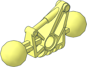

Errors Found (HN)

I put some feedback in the forum, have a look here:
https://forums.ldraw.org/thread-26124-post-45360.html#pid45360
Max Murtazin [SwampKryakwa]
2022-03-18 15:35:01
Added conditional lines, fixed outlines and geometry, replace of some elements with primitives, replaced axle primitive with set of proper ones
Existing certification-votes were deleted.
2022-03-18 15:40:01
Restored accidentally removed cylinder
Willy Tschager [Holly-Wood]
posted a vote of Hold
2022-03-30 13:25:02
* Rounding
* Quads near coplanarity
* Coplanar quads
* Invalid use of upper & mixed case in subfile name
* Flat subfile scaled in y direction
* Invalid us of BFC INVERTNEXT on flat subfiles
* Missing edges (example)
2 4 3.205632 -28.548836 23.124964 3.003786 -29.135415 24.002667
2 4 3.003786 -29.135415 24.002667 2.901834 -29.431316 24.445427
2 4 3.21498 -28.523798 23.10823 3.557525 -27.390524 22.350851
* However it would be better if you eliminate these:
3 1 4.2115 -25.6706 26.0032 2.7904 -29.7476 23.6492 3.0515 -28.9896 22.6392
3 1 4.2115 -25.6706 26.0032 2.6293 -30.2176 24.7852 2.7904 -29.7476 23.6492
building a proper surface:
4 27 2.902 -29.431 24.445 2.629 -30.218 24.785 2.79 -29.748 23.649 3.215 -28.524 23.108
4 27 3.215 -28.524 23.108 2.79 -29.748 23.649 3.052 -28.99 22.639 3.61 -27.228 22.242
* The part is already slip in half:
4 73 3.0515 -28.9896 22.6392 0 -28.9896 22.6392 0 -9.5717 -2.2374 10 -9.5717 -2.2374
4 73 -3.0515 -28.9896 22.6392 -10 -9.5717 -2.2374 0 -9.5717 -2.2374 0 -28.9896 22.6392
Why didn't you subfile?
* Coplanar quads
2022-04-01 15:05:01
Separated main geometry into the subpart, fixed quad coplanarity, flat subfile Y scaling, use of BFC INVERTNEXT on flat subfiles, added missing edgelines
2022-04-01 15:05:01
Removal of accidentally left unnecessary cylinder
made the following comment.
2022-04-01 15:30:01
I see no reason to have all these history comments.
Please delete them, but do please tell us what you have changed when you upload a new version.
I think you could use the same comment type as we use when we prepare ldd data.
Something like this:
0 !HISTORY 2013-08-14 [SwampKryakwa] Original part shape by Lehvak Nuva
0 !HISTORY 2018-07-22 [SwampKryakwa] File preparation for LDraw Parts Tracker with consent of oiginal author
Any comment on this, Orion?

Just to pile onto Magnus's comment:
This is a new part authored by you. You don't have to add a history line every time you make an edit. History lines should be made if:
- You are not the part author -or-
- You update an official part and have it resubmitted to the tracker
And multiple sequential line by the same person can be combined into one. The most important reason for history is to document who has changed a file.

Okay, I understand now. Should I re-upload file without history lines mentioning various edits then?

* Missing intersections:
1 4 -5.38661 -14.7796 -16.316 0 5.38612 0 3.684 0 0 0 0 3.684 4-4cylc3.dat
1 4 0 -19.3036 3.17418 1 0 0 0 .2368 .9715 0 -.9715 .2368 s\47311s01.dat
* What's the reason for s01?
* Should use a:
1 16 0 0 0 0 -1 0 1 0 0 0 0 1 connhole.dat
instead of pegholes+cyli
* Lots of blanks between the figures
* IMHO the half cylinders:
1 16 5.38661 -14.7796 -16.316 0 -5.38612 0 3.684 0 0 0 0 3.684 4-4cylc3.dat
should actually be a cylc covering the entire lenght + a disc
* HISTORY lines not needed as progress is documented in PT

Replaced primitives making up pinhole with a proper primitive, replaced outer arm cylinder with the half cylinder, renumerated pb04 as pb01, old pb01 is part of the main file now. Moved cylinders into main subfile

Fixed accidentally inversed cylinder

* Some rounding required:
1 16 .000000000000000000000000000000456 -20.038138168885785496384262605933 6.1846642000000460496861684733439 0 0 3.44 3.3419600000000511200853296593222 -1.7917345782153980282913915663261 0 .81541606459503746855617121608742 7.343374200000112327471217973513 0 4-4cylse.dat
* My suggestion for fixing this bleeding:
3 1 -4.2427 12.5135 -5.3614 -2.2961 13.5812 -6.135 -2.2961 14.386 -3.1132
4 4 -5.6098 7.8877 -9.3792 -5.5433 7.0972 -10.0157 -4.2427 8.0999 -11.7154 -4.2427 9.3476 -10.8554
would be copying the prim temporarily to s01 and merge the vertices to the prim.
* As you have to fix the edges in s01 anyway I would suggest that you merge first:
-9.5359 3.4745 -8.2949
to the edge of:
1 16 10 0 0 0 -20 0 -6.36 0 6.36 -6.36 0 -6.36 2-4cyli.dat

Dividing large flat surfaces into 2 halves, like these (and many more), is never a good idea:
4 12 8.6191 9.2795 -20 3.5191 -14.7796 -20 -3.5191 -14.7796 -20 -8.6191 9.2795 -20
4 12 -9.5359 3.4745 -8.2949 9.5359 3.4745 -8.2949 8.897 9.6275 -18.8355 -8.897 9.6275 -18.8355
4 12 -4.3072 -16.1891 -12.9123 4.3071 -16.1893 -12.9124 7.9338 -6.3639 -6.3639 -7.9338 -6.3639 -6.3639
4 12 10.0127 -9.568 -2.2374 -10.0127 -9.568 -2.2374 -10.0138 -6.3639 -6.3639 10 -6.3639 -6.3639
4 12 -3.0234 -28.9784 22.6391 3.0234 -28.9784 22.6391 2.7513 -29.7337 23.6491 -2.7513 -29.7337 23.6491
4 12 2.5819 -30.2008 24.7851 -2.5819 -30.2008 24.7851 -2.7513 -29.7337 23.6491 2.7513 -29.7337 23.6491
4 12 2.5819 -30.2008 24.7851 2.5223 -30.3599 26.0031 -2.5223 -30.3599 26.0031 -2.5819 -30.2008 24.7851
This one is never made in trans plastic. Right?
I don't understand the use of a ndis and a axleho10 at the base of one of the axles. This only adds triangles in the mesh that no one will ever see.

Reason for using ndis and axleho10 is keeping geometry convex. Generally, non-convex geometry might be harmful to the renders. Some software, like Studio, also uses custom Hi-Res primitives for axles and some other stuff. I want to ensure that model wouldn't have problems with any LDraw-powered software, and because of that I also come to use such methods, despite that they might look like unnecessary additions.
As far as I'm aware LDraw standards doesn't restrict this, if I'm wrong I will rework part around axle, but I'd prefer it to be kept if possible

Fixed geometry

I still don't understand why flat surfaces are made from many tiny triangles, or divided in the subfiles.
4 5 8.6191 9.2795 -20 3.5191 -14.7796 -20 -3.5191 -14.7796 -20 -8.6191 9.2795 -20
4 5 -9.0017 -9.8434 20 9.0017 -9.8434 20 9 9 20 -9.0017 9 20
Adding this doesn't make the surface convex.
3 16 10.0127 -9.568 -2.2374 0 -6.3639 -6.3639 0 -6.3419 -6.3639
3 16 -10.0127 -9.568 -2.2374 0 -6.3639 -6.3639 0 -6.3419 -6.3639
The file contain some editing relicts from LDPE
Missing or misplaced edge lines
2 4 9 4.1675 -9.4766 9.0017 3.4437 -8.3163
2 4 9.0017 3.4437 -8.3163 9.5359 3.4745 -8.2949
2 4 5.6516 -21.6001 26.0032 5.531456 -21.926562 27.585929
2 4 5.531456 -21.926562 27.585929 5.2193 -22.7924 28.8814
Thin gaps or T-junctions here
2 4 9 9 20 9 9 15.9
2 4 9 9 12.6 9 9 7.9
2 4 9 9 4.6 9 9 0
2 4 9 9.0321 -2.8398 9 7.044 -7.098
2 4 9 4.1675 -9.4766 9 5.913 -8.011
This surface doesn't work well
3 11 2.7536 -11.6436 -14.1151 5.2319 -11.6659 -14.1344 5.0286 -11.0123 -15.9998
3 11 5.0286 -11.0123 -15.9998 2.7536 -11.0406 -16.0241 2.7536 -11.6436 -14.1151
4 12 .00051 -11.0956 -16.316 .00051 -11.3759524 -14.9061332 5.38661 -11.3759524 -14.9061332 5.38661 -11.0956 -16.316
4 12 .00051 -11.3759524 -14.9061332 .00051 -12.1746436 -13.7110436 5.38661 -12.1746436 -13.7110436 5.38661 -11.3759524 -14.9061332
..and yes, I know many of these are in the subfile.

Fix of mentioned issues

Fixed outlines, rounded
2022-12-04 13:35:01
Improved part accuracy

* Missing edges:
2 14 -2.7536 -19.7325 24.7168 -2.7536 -2.313 10.698
2 14 2.7536 -19.7325 24.7168 2.7536 -2.313 10.698
2 2 -9 7.117 5.237 -10.0006 7.117 5.237
2 2 9 7.117 5.237 10.0006 7.117 5.237
* Superfluouse empty prims:
1 16 0 0 20 6 0 0 0 0 6 0 -1 0 1-16disc.dat
1 16 0 0 20 6 0 0 0 0 -6 0 -1 0 1-16chrd.dat
1 16 0 0 20 -6 0 0 0 0 6 0 -1 0 1-16chrd.dat
1 16 0 0 20 -6 0 0 0 0 -6 0 -1 0 1-16chrd.dat
1 16 0 0 20 0 0 6 6 0 0 0 -1 0 1-16chrd.dat
1 16 0 0 20 0 0 6 -6 0 0 0 -1 0 1-16chrd.dat
1 16 0 0 20 0 0 -6 6 0 0 0 -1 0 1-16chrd.dat
1 16 0 0 20 0 0 -6 -6 0 0 0 -1 0 1-16chrd.dat

This is not needed, only adding duplicated surface.
1 16 0 6.11904 -8.33407 9 0 0 0 -1 3.51227 0 0 -8.33361 2-4ering.dat

Fixed issues, moved few prims to the subfile

I wonder,
Could you close the gap that comes when the prims in the s02-subfiles are in hi-res mode?
The bow between the s02-subfiles is still in normal resolution when the s02 is in hi-res.
There is already an 2-4ering in one of the problematic gaps
1 16 0 6.11904 -8.33407 6 0 0 0 -1 2.34151 0 0 -5.55574 2-4edge.dat
1 16 0 6.11904 -8.33407 6 0 0 0 -1 2.34151 0 0 -5.55574 2-4ering.dat
But I don't like the shape shifting 2-4edge prim..... Hm
It looks to me like the bow is part of a torus. Something like this shape?

Hi-res mode is definitely causing some problems. I will try replacing the toroidal sections with cylis and cylses, so far looks like the only fitting solution to me

Also, is there any preference for part being oriented like on official renders? Better be rotated 180 degrees along Y if that's the case: https://img.bricklink.com/ItemImage/PN/59/47311.png

Holding it for myself - need to get bit more work done on this

Source of geometry hasn't agreed to CA.

Missing all conditional edgelines
Missing edgelines on intersection surfaces
Using complete cylinder primitives where a semi cylinder would be enough.
Using a complete axle.dat primitive instead of appropriate axle primitives.
Trailing zero error.
Divided large surfaces across major-axis into left/right halves.
I strongly recommend that you study the Ldraw Standards documentation.
