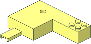

Unofficial File parts/u9224b.dat
0 ~Train Track 12V Tapered Point Left Housing
0 Name: u9224b.dat
0 Author: Steffen [Steffen]
0 !CATEGORY Train
0 !HISTORY 2023-10-01 [Blechtaler] with cable slot and adapted to the reworked u9226
1 16 0 0 0 1 0 0 0 1 0 0 0 1 s\u9224bs01.dat
1 16 40 0 10 1 0 0 0 1 0 0 0 1 stug-2x2.dat

its not completely the same, the original version was flatter (but I checked the real part and corrected it)
Rene Rechthaler [Blechtaler]
made the following comment.
2024-12-27 13:49:39
should this one get renamed to u9224a because the dimensions changed?
2024-12-27 14:09:03
Yes.
I think this needs a new number, not u9224a, or b.
Looks like you have moved the studs. The height is different. Right?
2024-12-27 14:37:49
no, the studs are the same...
the height got changed from 24 to 30LDU (in the subfile)
should the origin then also get moved to the center of the studs?
(i have these parts, but no numbers visible...)
Electric and manual switches have the same top, just different internals.
(no need for a different number, u9224a is ok)
(should I then take ownership for the s01, changed pretty much everything there)
2024-12-27 15:16:13
Ok, the stug is still on the same vertical level, but how will the change in height affect the assemblies using this part?
2024-12-27 15:19:25
... how will it affect the _official_ assemblies using this part?

i will have to redo all other official assemblies anyways because of u9226 (split in a+b)
all these reworked assemblies also need a reworked s\864s01.dat

however, I suggest to simplify the !HISTORY line to just
"added cable slot"
