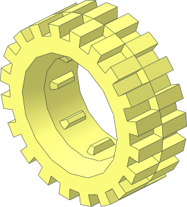

Rene Rechthaler [Blechtaler]
2025-02-26 11:17:06
the old official 2346 is too far off from the real part, i made a new one (with prims and subparts)
should I keep the history of the old part?
made the following comment.
2025-02-26 11:22:52
outer dimensions are now like 56897 (R38, W26), which is much closer to the real part than the old 2346 (R35, W30)
also fitted to match the rim family (is the inside ring ok or should it use the 8 ridges?)
2025-02-26 20:04:33
Is that even the same tyre?
2025-02-26 20:23:50
no, complete rework (the original part is just very wrong...)
2025-02-27 16:58:43
We need to consider the descriptions on all these tyre+rim combinations.
Is "12/ 50 x 16 " still a match to the real part?
2025-02-27 17:16:40
Outer dimensions are D30x10,5mm/R38, W26 (same as 56897, but I dont have that)
for the standard D17x7mm rims (should be R21 instead of 22 LDU but I dont want to correct the whole family)
number 2346 is embossed on it, one of the few rubber parts with number
2025-02-27 17:38:38
should I reuse s\3634a.dat here? the inside doesnt use the continuous rib like the old ones
2025-03-03 11:31:04
with the teeth from 3634
renamed the part.
2025-03-04 21:16:15
When the first version turns out to be wrong, the second should be called b.
