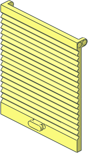

Gerald Lasser [GeraldLasser]
2025-06-05 19:46:51
Added glass holder holes to 6154 and added 40527 for door only version
made the following comment.
2025-06-05 19:51:35
currently no Obsoleting is required.
However this one has a bad origin, the origin should better be at the front dimple, as the back dimple is used to fix the door in the position.
Should we change the origin? that would make it a "b" version...
Philippe Hurbain [Philo]
2025-06-05 20:18:09
Imho obsoleting should be avoided as much as possible...
Rene Rechthaler [Blechtaler]
2025-06-05 20:27:37
front bump is the hinge -> should be origin -> obsolete
2025-06-05 20:53:58
No overall mechanical change -> no obsoleting.
2025-06-05 21:15:24
but moving the origin is a reason, and the origin should be at the hinge...
2025-06-05 21:20:13
I agree with Philo, we should avoid obsoleting, but here the rotation point is "off grid", at z=-4.75.
Hard to set even with LDCad. I think we should obsolete.
2025-06-05 22:25:43
I am also very much against obsoleting as it gets the overall references mixed up, but the rotation point is the most compelling reason here.
Peter Blomberg [WUIt]
2025-10-31 01:37:23
I'm not giving certify until the origin has been fixed.
