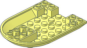

This part appears in MLCad (and probably also in LDview) with holes where you can see through the bottom. It is a pretty common part since it is in the top 1500 most common parts from sets this year (2025). I would love to see it fixed.

Don't get it.
What do you think needs to be fixed?

AFAIK The part has all the holes, did you check the 3D view? Click on the part image

I can't see anything really wrong either, except that the front stud holes are missing an edge line
(1 16 10 16 -50 4 0 0 0 1 0 0 0 4 4-4edge.dat and 1 16 10 16 -30 4 0 0 0 1 0 0 0 4 4-4edge.dat in s01)

When I load the file in MLCad, I get the error "File s\5117s03.dat not found! Continue loading?" If I press yes, I also see the error "File s\5124s02.dat not found! Continue loading?"

you can see how it renders with the missing files at: https://brickarchitect.com/content/temp/5123_rendering_error.png

Looks like you need to update your official library.
Do you have parts 5117 and 5124? These, and their subfiles are official, and the subfiles are used by 5123.

Thank you Magnus. I do not know why these are missing since I keep my libraries up to date and just installed the 2025-07 version of the "Complete LDraw.org Library Windows installer" earlier today, but I will try a full uninstall/reinstall tomorrow.

I can see both s\5117s03.dat and s\5124s02.dat in the latest COMPLETE.ZIP

did you try the "download zip file" at the top of this page? that should contain all subparts and prims needed...
