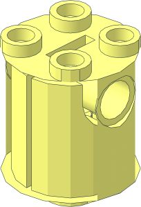

Unofficial File parts/s/30361ds02.dat
~Cylinder  2 x  2 x  2 Robot Body with Axle Holder 90 Degrees without Front and Back Faces

2026-05-07 18:55:40
*made the back of d-version patternable for 2022 R2-D2 torso
*used common geometry for a and d version
Explanation on versions:
a - no axle connector in central tube, used around ca. 1999-2001 (some 2002/2003 sets might have had leftover stock). Hole goes through entire part.
b - axle connector at 45 degree (not yet in LDraw), used in 2002 only?
c - axle connector at 90 degree, used since 2003 (not in LDraw)
d - same as c, but with minor difference in axle connector design, not sure when this started appearing, but it seems to be the current version
Bricklink has a good comparison image.
made the following comment.
2026-05-07 19:33:00
IMO, some of the overlaps and "bad" code should be re-written.
The double rings on the bottom is "hurting my eyes".
Could we use a proper bottom stud instead?
