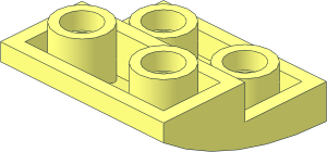

0 Slope Brick Curved 2 x 2 x 0.667 Inverted
0 Name: 32803.dat
0 !CATEGORY Slope
0 !KEYWORDS Brickowl 301153
0 !HISTORY 2017-12-04 [GeraldLasser] part derived from 24201
0 !HISTORY 2026-06-15 [Sirio] Changed description; changed shape of rounded face; move edges to 16 and 2
1 16 0 0 0 1 0 0 0 1 0 0 0 1 s\32803s01.dat
1 16 20 -24.9719 30 0 -40 0 26.9719 0 30.9717 -40 0 40 48\1-8cyli.dat

while it is back on the tracker, it should get subfiled without the "main" surface (because its is now printed)
https://rebrickable.com/parts/32803pr0001/slope-curved-2-x-2-x-23-inverted-with-whitelight-bluish-grey-headlight-print/

Moved front lip to Y = 2.
If you like this solution, I will update 24201b01, 32803b01 and so on.

is this too far off for a fix or acceptable? or does this need an obsoletization/b-index?
would unrotated prims fit better? (starting point of the prims at the bottom instead of at the lip)

As there only two shortcuts which are still unofficial, I think we can go without obsoleting it.
24201 has no stickers or patterns at all yet.
So IMHO, not obsoleting it is a way forward
