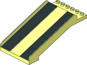

I'm curious of the shape of the track bars (here trapezoid/trapezium). I noticed that planar tracks (e.g 6377) have had a simpler triangular shape (tri4). Looking at the physical parts, I'd say the real shape should be a box5. However, would it be best to consistently use tri4?

and some fillets in the stud8 area, which I probably won'T add
