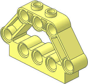

0 Technic Brick 5 x 3 x 1 with 8 Pegholes and 2 Studs

2023-02-20 18:08:29
The cavities in the top beam should use npeghol primitives.
Lots of overlapping surfaces and T-junctions.
Vincent Messenet [Cheenzo]
2023-03-06 08:07:21
made the following comment.
2023-03-06 08:09:39
I could not find any npeghol primitive fitting this part. Can you please advise which one(s) should be used?

Gerald Lasser [GeraldLasser]
posted a vote of Hold
2024-11-20 23:01:45
The two cyli added here are bleeding through the surface partially:
replace:
1 13 0 50 10 -8.30974 0 3.44201 -3.44201 0 -8.30974 0 -20 0 3-8cyli.dat
1 13 0 50 10 -6.36 0 6.36 -6.36 0 -6.36 0 -1 0 1-4edge.dat
1 13 0 50 -10 -6.36 0 6.36 -6.36 0 -6.36 0 -1 0 1-4edge.dat
with
1 13 0 50 10 0 0 -9 -9 0 0 0 -20 0 1-8cylo.dat
1 13 0 50 10 0 0 9 -9 0 0 0 -20 0 1-8cylo.dat
plus the two quads to complete the bow, half of this could be added also in s01,
don't forget the complementary cond.
same at the top, bleeding clyi.
replace
1 13 0 10 10 6.36396 0 6.36396 -6.36396 0 6.36396 0 -20 0 3-4cyli.dat
1 13 0 10 -10 6.36396 0 -6.36396 6.36396 0 6.36396 0 1 0 1-4edge.dat
1 13 0 10 10 6.36396 0 -6.36396 6.36396 0 6.36396 0 1 0 1-4edge.dat
either here with (or in s01)
1 13 0 10 10 0 0 -9 9 0 0 0 -20 0 1-8cylo.dat
1 13 0 10 10 0 0 9 9 0 0 0 -20 0 1-8cylo.dat
rest follows in s02
replace:
with
replace
rest follows in s02
2025-07-18 07:05:01
Fixed bleeding issues
