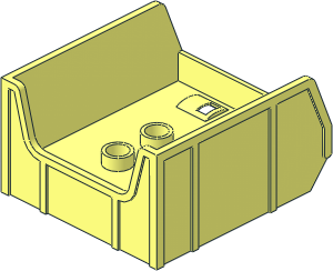

Certify
Gerald Lasser [GeraldLasser]
Peter Blomberg [WUIt]
2025-05-04 19:14:14
made the following comment.
2025-05-14 09:14:55
I think it is better to change 0 BFC INVERTNEXT
1 16 0 24 17 74 0 0 0 -20 0 0 0 57 box4-4a.dat
Into a box3 to cover the vertical walls and add the horizontal surfaces required to close it partially into s01
The box3 should then also cover those areas
4 16 74 24 -76 74 4 -76 74 4 -40 74 24 -40
4 16 -74 24 -76 -74 4 -76 -74 4 -40 -74 24 -40
They would need to go from s02 (along with the edge lines which should come from box3)
Instead of
1 16 0 -24 -98 0 0 74 0 1 0 -2 0 0 rect.dat
4 16 74 0 -96 -74 0 -96 -74 -24 -96 74 -24 -96
Use
1 13 0 -12 -98 -74 0 0 0 -12 0 0 0 2 box2-5.dat
Be sure to remove the edges it will provide also in the subfiles, I think they are in s02
2025-05-17 12:31:17
Used more/different boxes as suggested.
posted a vote of Certify
2025-05-19 22:22:55
posted a vote of Hold
2025-05-24 23:18:26
Apparently, the origin should be at the hinge.
2025-05-25 08:55:14
Corrected origin to centre of hinge.
2025-06-08 09:04:01
Rene Rechthaler [Blechtaler]
2025-06-08 10:45:09
2025-06-22 14:02:50
Needs a rotation 180 degree to match the orientation of the hinge base 13355, and all other tipper buckets.
The Help info is corrupt. You can't mirror a part like that.
2025-07-21 03:37:49
Rotated 180° as suggested. Fixed HELP. Rotated subfiles to match.
2025-10-16 19:10:35
