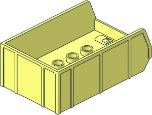

Gerald Lasser [GeraldLasser]
Peter Blomberg [WUIt]
2025-05-04 19:14:14
made the following comment.
2025-05-14 09:18:59
I suggested a few changes for the sister part 14094, that should be taken into account here as well
2025-05-17 12:31:17
Used more/different boxes as suggested.
posted a vote of Hold
2025-05-19 22:29:08
as in 14094
this
1 16 0 -24 -138 0 0 74 0 1 0 -2 0 0 rect.dat
4 16 74 0 -136 -74 0 -136 -74 -24 -136 74 -24 -136
should use a (copied from 14094)
1 16 0 -12 -98 -74 0 0 0 -12 0 0 0 2 box2-5.dat
as edges are now misisng due to the rework of the subfiles
2025-05-20 23:56:16
Thanks!
Fixed as suggested.
posted a vote of Certify
2025-05-24 17:12:56
2025-05-24 23:17:50
Apparently, the origin should be at the hinge.
2025-05-25 08:55:14
Corrected origin to centre of hinge.
2025-06-08 09:04:20
Rene Rechthaler [Blechtaler]
2025-06-08 10:44:12
2025-06-22 14:02:54
Needs a rotation 180 degree to match the orientation of the hinge base 13355, and all other tipper buckets.
The Help info is corrupt. You can't mirror a part like that.
2025-06-23 10:51:51
Magnus is right, it should be oriented like to ohter tippers in the library. Part geometry is fine
2025-07-21 03:37:49
Rotated 180° as suggested. Fixed HELP. Rotated subfiles to match.
2025-10-16 19:08:10
2025-10-16 19:10:04
It is interesting ( and I had to check a pic) that the underside studs are not shortened as usually with Duplo.
