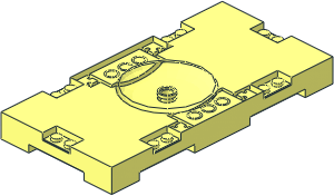

2025-07-18 05:01:55
made the following comment.
2025-07-18 05:09:02
2025-07-19 04:36:06
*corrected center pin height and length
*corrected dimple diameter
*corrected underpin positions
*added bottom chamfers and top cutouts (plate removal helpers)
*added stud connector ribs in side cavities
*sub-filed patternable area
*reworked main geometry from scratch to remove various smaller issues
*sub-filed to re-use in 30492 and 41819
There is a small overlap on the bottom, between the dimple and the center anti-stud. Not sure if that is problematic enough to rework that area.
2025-07-19 04:39:18
*Moved top surface 4-4edge to sub-file
The reverse of the "pit" still has the old radius. Is there any need to change this?
Very old part and only checked the file on surface level.
