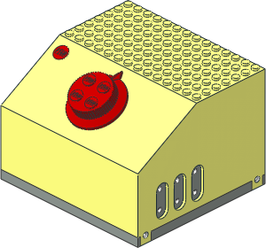

I didnt model the knob yet

The parttype and structure is not right.
This must be a "bottom plate part" and a "top cover part".
The subfiles need renumebring and this assy shoud be a Shortcut.
But don't upload new versions under a new number. Ask for a renumbering.

with knob and cable, still needs renumber/rename

Could you please stop uploading files you know is not correct.
The numbering and structure is not right in this case.
The library Admin will have enough to do anyway.

already asked here and in the forum, didnt get any answers...

If we don't know the partnumbers a uXXXX-number should be used. I can see in the list that you have been given a set of numbers. Use those.
It is easy to see that this is an assembly of 4 parts. Top, bottom, a red dial, and a grey cord.
IMO, 740a is a good choise as a base. Each of the parts should get a uXXXX-number, and might use as many subparts as needed.
The trafos, without the cord, should be 740ap01 and 740ap02.
This assembly (we call them "shortcut") could then be numbered 740ap01c01.
There is a need for a second assy, with an uncoloured bottomplate 740ap02c01.
More details in this image:
https://forums.ldraw.org/thread-27465-post-50975.html#pid50975
But since all files are now uploaded you need to send a mail to [email protected] and ask for help in renumbering all ot the files.

Renumbering has been done.
The file still need some clean-up by the author.

thanks for the renumbering, cleaned it a bit...

The metal axle under the red knob is part of the knob. Right?

more like part of the internals (which arent modeled)...
thats the axle of the autotransformer, which has the knob on the axle.
(this transformer is smooth like the Type 3, with a click in the center)

should the metal parts (axle, rivets) get their own ~parts? which numbers then?

fixed the origin, added the cable cutout

added !HELP for the connections (there are 3 plug sockets for different outputs)

bottom imprints with electrical data

does anyone have the non-EU-plug version? or even the 120V version (Part number 742)?

changed to shortcut without cable
(more compact, no holes in shell)
