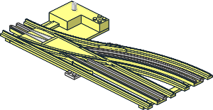

Unofficial File parts/u9232b.dat
0 ~Train Track 12V Tapered Point Left Electric (Straight)
0 Name: u9232b.dat
0 Author: Steffen [Steffen]
0 !CATEGORY Train
0 !KEYWORDS Bricklink sw12v1leftA, Rebrickable upn0388la, Set 754
0 !HISTORY 2023-10-01 [Blechtaler] with cable slot and adapted to the reworked u9226
0 !HISTORY 2025-04-26 [Blechtaler] added cable end
0 // Needs Work: This assembly does not yet reference the point's
0 // moving rail part. It has to be added in its proper position,
0 // and the position of the actuator adjusted accordingly.
1 16 0 0 0 1 0 0 0 1 0 0 0 1 u9220.dat
1 15 0 16 0 0 0 1 0 1 0 -1 0 0 u9033.dat
1 16 -180 16 180 1 0 0 0 1 0 0 0 1 u9222.dat
1 16 -180 -14 180 1 0 0 0 1 0 0 0 1 u9224b.dat
1 79 -240 -16 180 -1 0 0 0 1 0 0 0 1 u9226b.dat
1 375 -280 11 183 0 4 0 0 0 -1 1 0 0 u9609.dat
1 375 -280 11 183 0 1 0 0 0 -1 1 0 0 s\u9609s03.dat

now both 9226 and 24 have a changed origin...
Rene Rechthaler [Blechtaler]
made the following comment.
2024-03-02 15:19:38
i guess I have to change the bottom plate now...

bottom plate reworked
do we need more insides (gearrack+spring)?
does anyone want to rework the main switch part u9220?

A shortcut can't use a subfile.
2025-05-01 13:59:54
https://library.ldraw.org/parts/17006
https://library.ldraw.org/parts/19523
used in all motor and plug shortcuts...
should I add a cabled shortcut? which number should that have?

should the cabled shortcut be c01 or should the "branching" one be c01?
I didnt change the origin, but size and position, does it also needs to be obsoleted?
